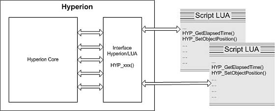

The Demoniak3D/LUA API (Application Programming Interface) is the whole set of the functions that let a program written in LUA scripting language to exchange data and handle actions with Demoniak3D:
A lua scripting code may be integrated within the XML code of a Hypergraph in several ways, using the following nodes:
  • with the <script> node: it is the most direct and the simplest way.
  • with the <hotkey> node: a LUA script is launched when pressing a key.
  • with the <interval> node: LUA scripts are lauched whether at the beginning or during the interval.
  • with the <mouse> node: LUA scripts may be lauched in risponse to the mouse events.
  • with the <play_list> node: LUA scripts may be lauched with each audio track of the playlist.
  • with the <sequence> node: LUA scripts may be lauched within the actions.
  • with the <timer> node: a LUA script is launched at each time-out.

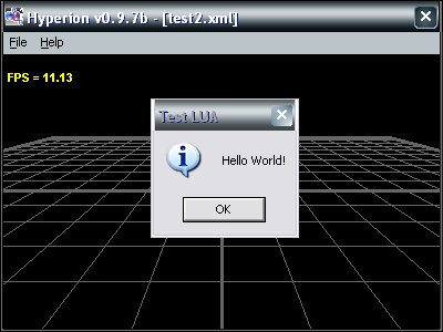

Here is a very simple LUA script code which displays the output of the classic programming code: "Hello World!":
-- This is a comment.
-- This is the Hello World of the LUA programming.
text = "Hello World!";
HYP_MsgBox( "Test LUA", text );
In order to run this script, just insert the following code in the Demoniak3D main XML source code:
