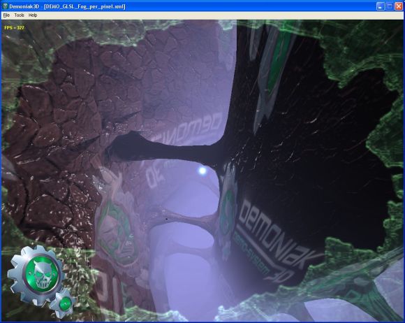

3 - Per Vertex Fog Computation
The following code is the complete shader code, used in the Demoniak3D demo. This shader shows how to add fog to a bump mapping rendered scene . In this first shader, the fog factor is computed per-vertex .

Fog Factor - GL_LINEAR - GL_EXP - GL_EXP2
DEMO_GLSL_Fog_per_vertex.xml

At the pixel shader level, the use of the fog occurs in the last line :
gl_FragColor = mix(gl_Fog.color, finalColor, fogFactor );
This line permits to make a color interpolation between the fog's color (gl_Fog.color) and that of the fragment (finalColor) accordingly to the fog factor value .
