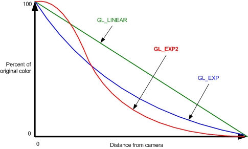

The following chart shows the fog factor evolution according to the distance :
Fog Factor - GL_LINEAR - GL_EXP - GL_EXP2
