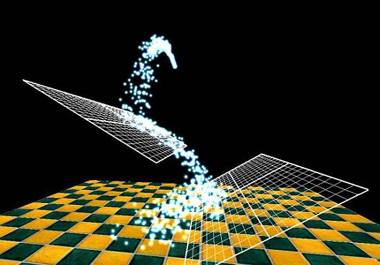

The image below, resulting from a Hyperion tutorial HyperGraph 29 shows a POINT type emitter associated with 1 GRAVITY type action and 2 PLANE type obstacles:
