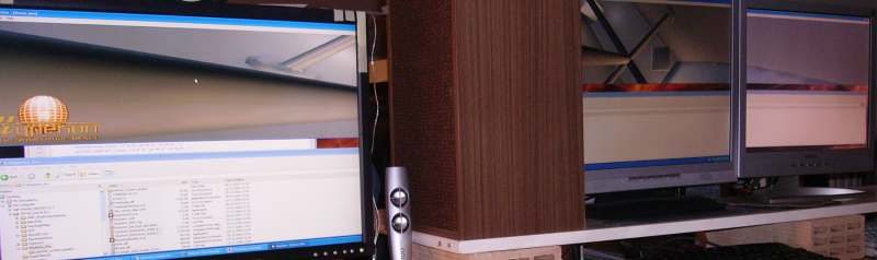

I did the test with two geforce 7600 gs in sli. I used the forceware 97.28. I spanned hyperion on 4 screens but it doesn't seem to work. But I managed to get Hyperion running well on 3 screens:
The Hyperion's scene size was: 3840x600
From that little test, I don't know if Hyperion will run properly on the quadro nvs 440.
