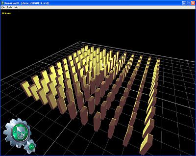

The issue is in the script : if I use the "HYP_Nx_Physics.AddBoxActorToScene(clone_id,2,10,5);" line, I get this :
Basically, a huge explosion. :mrgreen:
Unfortunately that's not what I try to do. I just want my set of dominos (a square, just like in code sample 41) to be added in the physics engine.
Any idea of what is wrong ? And why ?

With PhysX, you have to use PhysX's functions to set position, orientation:
Code: [Select]
clone_id = -1;
for j=0,10 do
z = -100.0 + j*20.0;
for i=0,10 do
clone_id = HYP_Object.Clone("box01");
x = -100.0 + i*20.0;
HYP_Object.SetRenderState( clone_id, 1);
HYP_Object.SetLightingState( clone_id, 1 );
HYP_Object.SetTexturingState( clone_id, 1 );
HYP_Object.RemoveSeam( clone_id );
HYP_Object.SetVBOState( clone_id, 1 );
-- HYP_Object.SetPosition( clone_id, x, 15.0, z);
ACTOR_DYNAMIC = 2;
density = 10.0;
mass = 5.0;
HYP_Nx_Physics.AddBoxActorToScene(clone_id, ACTOR_KINEMATIC, density, mass );
HYP_Nx_Physics.SetActorGlobalPosition( clone_id, x, 15.0, z );
end
end
With a closer camera:
Good luck with the rest  ;)
